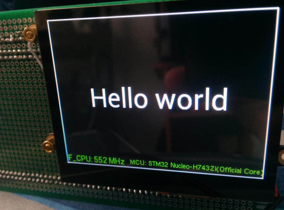

After a couple of years with the H743ZI core board in a drawer collecting dust, we finally managed to use it to connect a 3.5 "FT813 screen in SPI1 and in SPI3 a microSD reader for multimedia handling.
The Greiman SdFat library can work in core 1.8.0, so we have used it to manage multimedia files (jpg, png, assets, cells and avi videos with audio) from the microSD reader installed in SPI3.
We modify the library for gameduino 23x, so that it works with Greiman's SdFat library, we name this library as GD23ZU. It is a work in progress ...
Nucleo H743ZI + NHD FT813 3.5"

These are the modified variants with SPI3 active and some extra working frequency
