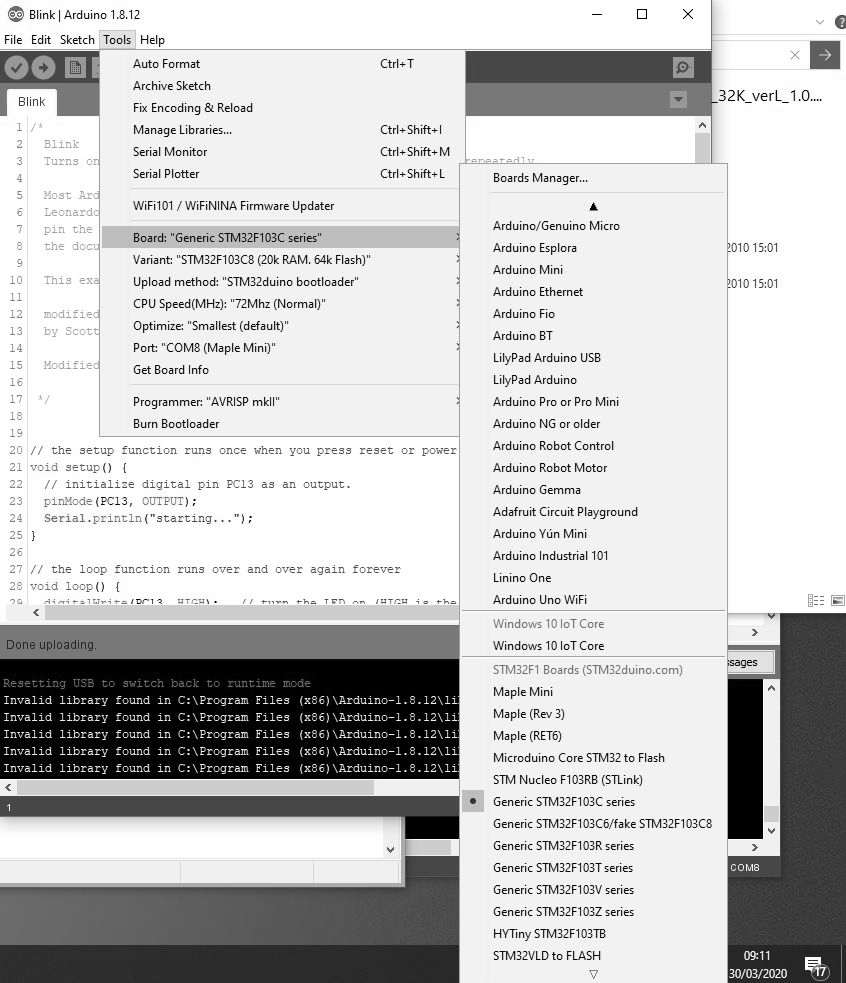

I have an old (9 years) Maple r5 complex program that was running well on Maple.
I am trying to port the app to a "STM32_Smart" board (resembling the STM32 Blue Pill), but have some problems in compiling.
The STM32 board runs the blink on USB OK.
I suspect that the STM32 board installation is not optimal for the more complex program (with registry and communication features).
Here are the details:
1. Running Windows 10 /64 Pro computer.
2. Board: STM32_Smart, MCU: STM32F103C8Tb

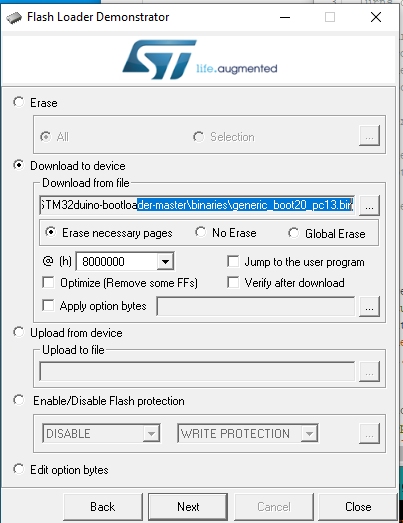

3. Run "ST Flash Loader Demonstrator" to boot the board.
4. Target: STM32F1_Med-density_64K
5. PID: 0410, Ver. 2.2
6. Selected 'Download to Device'. – Opens explorer searching for *.s19 files.
7. Selected Binary files, selected 'generic_boot20_pc13.bin' file. (out of long list of bin files)

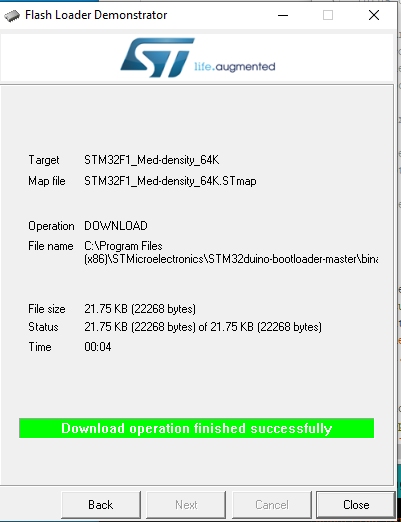

8. Next, 'Download finished successfully', Map file: STM32F1_Med-density_64K.STmap
9. Selected Board: "Generic STM32F103C series" (and also /fake STM32F103C8)
10. USB port installed as 'COM8 (Maple Mini)' ??
11. Blink program loads from USB and runs OK.
12. A more complex previous maple r5 program that was running on Maple with various register and communications, shows many errors and will not compile.
I suspect that I have the wrong bootloader / flasher.
Can anyone come with a hint to save me the time searching and trying (with the hope I can find something...)

Re: Arduino IDE for Maple r5 program on STM32F103C8 issue
The errors may eventually have to do with the upload method you use, but not with the bootloader itself and under no circumstances with the serial port. The com port number will be automatically assigned by the host (PC).
Since your system recognized the com port as maple mini, means that the serial driver is ok.
You have to check each error message and solve them one by one.
You can also post them here, then we can say more, not only guess.
You want to port the software for the bluepill, generic STM32F103xC device.
Therefore the bootloader should be adapted to that board, in order to be able to upload onto that board.
Obviously, this is the case because the PC recognizes the board as "Maple mini". That is fine, and as it should be.
So what it actually your problem?
You have been asked to post here the error messages, but you did not. Until you do that, do not expect more support.
Assuming you are talking about this board: https://stm32-base.org/boards/STM32F103 ... -V2.0.htmlsamtal wrote: Wed Apr 01, 2020 2:35 pm Does anyone know which binary, (Maple)DFU, Driver and (Maple)Serial Driver are the correct ones for the a/m board?
This has the same MCU as bluepill board, and has the LED on same PC13, so the same bootloader as for bluepill should work fine.
You also indicated that the blink sketch runs fine on that.
When you build your program, you have to select the generic STM32F193C8 series, as you did.
So it seems you have done the setup correctly.
The same serial driver as for bluepill should be installed, which you also did, that is why you get correctly indicated the serial port as "Maple Mini".
Does this answer your question?
What do you mean under "none of which works clean"? And which options do you mean?samtal wrote: Wed Apr 01, 2020 2:35 pm I have seen several options, none of which works clean, as I am used with Arduino.
If the LED blinks that means your setup is ok.
A totally different story is that some part of the program written for Maple r5 may not run on this board due to missing HW support, and/or different pin distribution.
This may cause the errors during the build process and/or wrong functionality.
Indeed, the board I use is the one shown in the previous reply.
I did use the Generic STM32F103C, Variant C8, but I did not get upload to be Maple DFU Bootloader 2.0. It is rather "STM32duino bootloader"
I installed the Maple DFU Driver and Maple Serial Driver. (STM32 Maple DFU Drivers, _STM_COM_drivers).
The COM port is shown as "Maple Mini", which is incorrect.
I can make the USB to run and the blink and other small programs to run (like BluePill-RTClock-test and my own RT clock), but they are not stable, fail after some resets, and occasionally will not load, at time I need to reload the bootloader.
The whole system does not seem to be stable and consistent. On some program uploads the program runs (I can tell by the blinking led I add in the prog), but there is no output to the USB port (or it is sent to another, unseen port).
I suspect the Maple COM port and DFU, although installed, are not used by the system.
As for the errors: At each program upload, although it loads and run, I get the error message:
"Starting download: [##################################################] finished!
error resetting after download: usb_reset: could not reset device, win error: A device which does not exist was specified.
state(8) = dfuMANIFEST-WAIT-RESET, status(0) = No error condition is present
Done!
Well, that is actually correct. The installed USB driver on your PC recognizes and indicates the VID:PID [1eaf:004] as "MAple mini", so please accept it once and for all, and don't blame it being the cause why your program does not work in a stable manner.
You should rather focus on your program, and on the way how do you use Serial.
It is recommended to use
while (!Serial); delay(10); // this waits for serial connection to be established
Also, before uploading, close the serial monitor. Arduino can have issues with that by uploading the program and resetting the board.
That error by uploading is "normal", so don't worry about that. It also has to do with Arduino and the host (PC) not able to manage the serial port re-enumeration correctly.
And don't suspect the drivers to cause trouble. Once the program is uploaded (100%), it means your system is up and running. You should rather check your SW.
