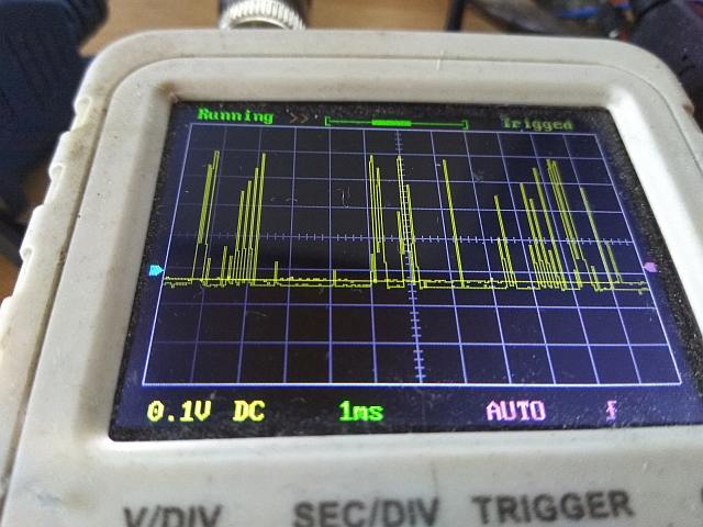

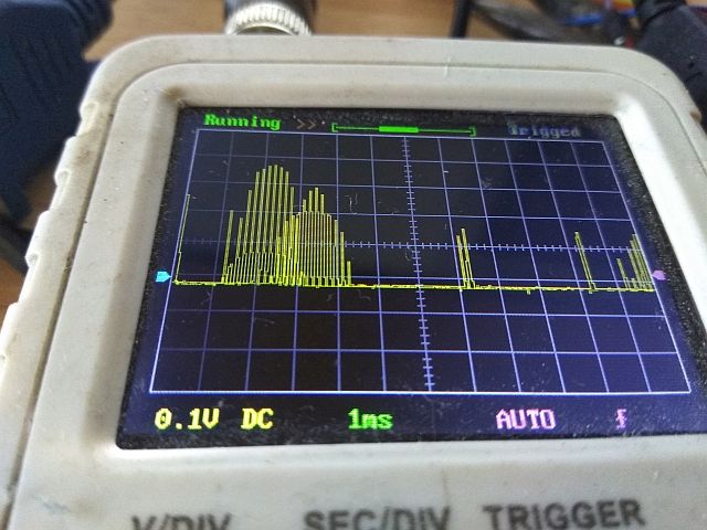

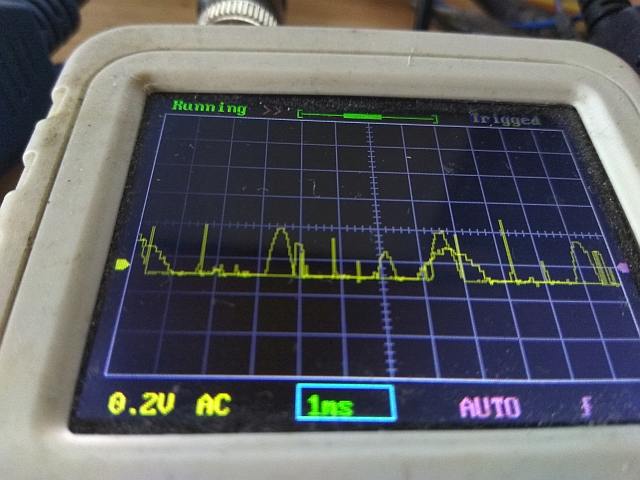

I tried to increase pwm frequency (one timer for interrupt, one for pwm), but it didn't help.
And then i looked at waveforms in oscilloscope, and everything was cleared why there is so much distortions. (i'll attach few pics from oscilloscope)
It is simply how sound is created.
On the other hand, maybe it's well suited for tesla coil...
