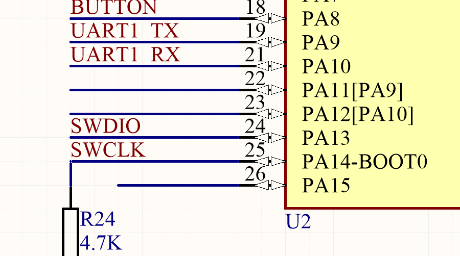

fpiSTM wrote: Sun Jan 31, 2021 1:51 pm Ahah! I've just remember why it does not work with USART1. ;)
This is linked to the pin used: PA9/PA10.
On G0 those pins could be remapped on PA11/PA12.
https://github.com/stm32duino/Arduino_C ... ssues/1180
This will be fixed in the next core release. As a workaround, simply comments the code described here:
https://github.com/stm32duino/Arduino_C ... -696617262
I have connected the uart1 pins to PA9 and PA10:
Re: STM32G070KB support
yes, that's why it doesn't work with the current version of the core you used. in fact the core remap to the pin 22/23.
So simply comment the code as mentioned in the GH issue and no remap will be done.
