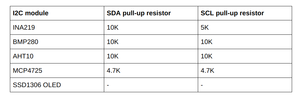

Usually these small BMP280/BME280 modules, as well as many other I2C modules, already have their own 4.7k or 10k pullup resistors. You can test with a multimeter, the resistance between SDA/SCL and Vcc.
