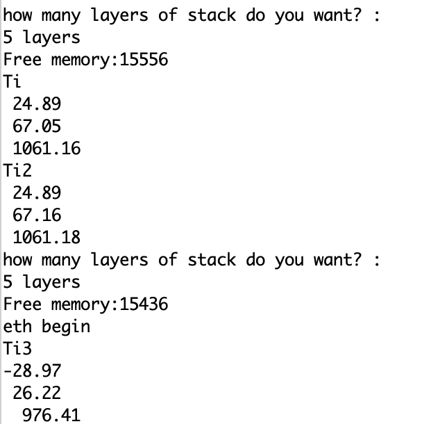

Hi there, Ive introduced the piece of code and I gave 5 wanted layers through serial. One time before the Ethernet.begin() and one after. This is the result:
Captura de pantalla 2021-07-04 a las 11.03.04.png (54.74 KiB) Viewed 7215 times
Does it give you a hint?

There is nothing obvious in the memory printout (IMO) other than there does not seem to be a substantial amount of memory being consumed by the Ethernet call to initialize ... thus, the stack numbers look nominal. I would expect, however, that as webpages are being built, the string assignments will consume memory unless the webpage is static except for displayed variables. This situation is best handled IMO by websockets/AJAX.

noticed something, initially you entered 5 layers of stack, it is 15556 bytes of free memory. the next time you run 5 layers again it is 15436.
well that isn't 'a lot' but does it become lesser and lesser if you run it n times? that could hint on a *memory leak*, very rare on a stm32f103 to find this. or more correctly 'no one' knows it happens ;/
that Freestack() thing is useful to insert deep in codes to 'check for free memory', i.e. call it once in a while deep in the codes, including in the libraries.
note that normally when things go back to loop() the stack is unwound and hence you have more 'free' memory, this also doesn't tell you if during the library calls, it go deep down, use up all that memory, overwrite some global variables then unwind everything and tells you have 15k 'free' memory, and that global variable(s) is smashed. oh well, these are supposed to be 'microcontrollers' after all, we are using them like that 8GB raspberry pi 4 these days :lol:

I doubt there is a memory leak, likely the function call to start the Ethernet initializes some local variables within the function. After all, he polled the stack, made a call, and polled the stack ... clearly, the function call
