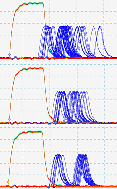

Well, I cracked it – sort of.
I spent the last week dissecting GonzoG’s code and watching it on the ‘scope. The two fast Read commands show the same waveform and time – about 55nS.
I also worked out how to do this in assembler – and got the same timings and waveform as GonzoG did with C!
I then worked out how to combine Read and Write which is what I wanted, the first stage in a fast ‘stopwatch’.
I wanted to show several ‘scope traces to illustrate some points but the forum wouldn’t accept them as they were too big, then I shrank them and it wouldn’t accept them as there were too many…
So here is one montage of two traces recorded in ‘persistence’ mode – where successive traces are overlaid on each other.
Both show asm pulses from a 5V 16MHz Nano taking 2 clock cycles (125nS) in red.
The blue trace shows the response from a Blue Pill running at default speed (72MHz) which is reading the input from the Nano and responding with a minimal 2 command pulse.
The scatter of the responses is due to the fact that the Pill is getting an input at random timing and is responding according to the ‘railway journey conundrum’.
The top trace is using a stripped down version of GonzoG’s software, the second trace is my first asm. Third is neater trace but with 2 branches in he asm..
What puzzles me is that some of the responses in the top trace are faster while others are significantly slower than those in the lower trace.
Any ideas?
Any ideas?
