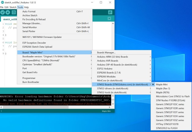

IanNoob wrote: Fri Oct 09, 2020 5:23 pm In your last paragraph you ask what cores I am using. I'm using a Blue Pill from Aliexpress. I spent 3 days following different protocols online to get them working with Arduino. I even soldered up a second Pill in case the first one was faulty. I downloaded some Maple software as well as STMCube Programmer but, to be honest, it works now but I have no idea which bits are doing what. Is there an easy way to see what I am actually using - "the older libmaple (Roger's) core or the newest STM Corporate core."?
I have heard this before, the short answer is the current board selected from the board Group. Below, I have the Maple Mini selected from Roger's Core, manually installed in {HOME}Arduino/hardware/
ArduinoIDE Board Selection_.jpg (59.85 KiB) Viewed 7223 times
Note: Roger's core has no installation file (no JSON) - it is just expanded (copied) with structure intact.
The longer answer is here: https://arduino.github.io/arduino-cli/p ... ification/
