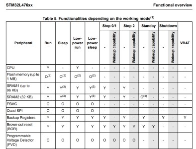

These things are discussed in both summary charts and details in the Reference Manual. Yes, the PDF is voluminous but easily searchable, but it should be opened in a window anytime you are doing coding of complex chip functionality.
