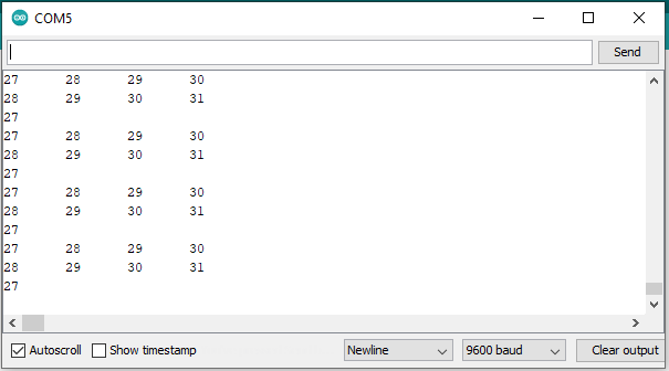

There is miss alignment between PB12 ~ PB15 and PB_12 ~ PB_15 for black pill.
Value for PB12 ~ PB15 is 27 ~30
Value for PB_12 ~ PB_15 is 28 ~ 31
It can be test by
void setup(void) {
  Serial1.begin(9600);
  Serial1.print(PB12);
  Serial.print("\t");
  Serial1.print(PB13);
  Serial.print("\t");
  Serial1.print(PB14);
  Serial.print("\t");
  Serial1.println(PB15);
  Serial1.print(PB_12);
  Serial.print("\t");
  Serial1.print(PB_13);
  Serial.print("\t");
  Serial1.print(PB_14);
  Serial.print("\t");
  Serial1.println(PB_15);
  Serial1.println(PB_11);
The result shown here

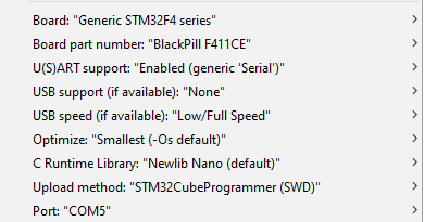

My computer development environment is: Windows 10 19043.1165, arduino IDE 1.8.16, core 2.0.0, upload method SWD through ST-LINK
Re: Black Pill miss alignment between PB12 ~ PB15 and PB_12 ~ PB_15
There is no issue.
PB12 is the pin number while PB_12 is the pin name which is a combination of GPIO Port and pin.
For PB11(pin number) as it is not available physically on the board, it is simply not defined.
