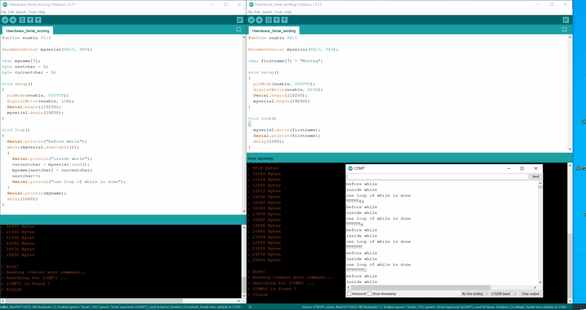

I am attempting to to send a message or from one STM32F103C8T6 board to another STM32F103C8T6 board. I have chosen PA10 and PA9 as my Rx and Tx for both the boards. And I have also assigned driver enable pin for both the pins (For Master PB15, which is always HIGH and for Slave PC14, which is always LOW). I am using HardwareSerial to read and write my data.
But I could able to send the data exactly to the slave from master. The ouput is printing just "??????". I dont know exactly where I am doing mistake. I am also attaching the screenshot and the codes that I am using to test the hardware serial.
My main task is to read and write the sensor values from the both the boards and and send them acorrding to algorithm given to the boards.
Hoping for responses from you.
Here below I am posting the code for my Master:

Webp.net-compress-image (1).jpg (89.1 KiB) Viewed 4775 times
by mustaq_ahm » Tue Sep 14, 2021 3:00 pm
Thank you for your time and replies. It was my simple mistake in code. Yes you correct nextchar++ is just index for myname.
In both master and slave. I have given different baud rates. That was causing the problem I think.
Also in Slave code. I removed semicoln in while statement. :D
Now everything works fine.

nextchar++; OK but it is never reset to 0. ;)
Moreover you suppose the while(myserial.available()); will only read the "firstname" but nothing ensure that only one is received... mainly because you made several print.

I added several print in my code because, so that I can debug in my own code in serail monitor.
Yes, you are right but myserial.available() will check for number bytes to recive when it is zero it will exit the while loop right?
I have also used nextchar++ so that it will store byte by byte to receiving end (myname) from the sending end(firstname).
Could you please elaborate where I am wrong?
Re: Hardware Serial sending data using USART.
nextchar is used as index of myname array.
So as you never reset it to 0 you go out of the array after 6 while loop...
