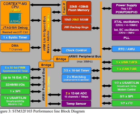

STM32F103 Internals.jpg (91.17 KiB) Viewed 1771 times
The STM32F103xx has a matrix internal connection (actually several different buses), flexible but not every internal connection to any external connection. The STM32Arduino core respects the internal matrix. The reference manual RM0008 is the authority.
2.2.1 System Architecture consists of Buses, and General purpose DMA (Direct Memory
Access), Internal SRAM, Internal Flash Memory which some of them consider as masters
and others consider as slaves.
There are four master parts and three slave parts in the architecture which are mentioned
below.
Masters:
I-bus (Cortex-M3 ICode bus): It connects the Cortex M3 core to the Flash memory
instruction in order to do prefeching.
D-bus (DCode bus): It connects the Cortex-M3 core to the Flash memory Data interface.
S-bus (System bus): It connects the Cortex-M3 core peripheral bus to a BoxMatrix in order to
control the arbitration between the DMA and Core.
GP-DMA bus (General Purpose DMA): It connects CPU(Central Processing Unit) and DMA
to the Flash memory, SRAM and Peripherals through BoxMatrix in order to make
communication between them.
Slaves:
Internal SRAM
AHB (Advanced High Performance Bus) to APB (Advanced Peripheral Bus) bridge: This
bridge divides AHP bus into two buses, APB1 and APB2. APB1 is for peripheral which their
frequency is 36 MHz and APB2 is for peripherals which they operate with 72 MHz
frequency.
This PDF does a fair job at covering the internal workings:
http://www.emcu.it/InsideCORTEX-1221142709.pdf
