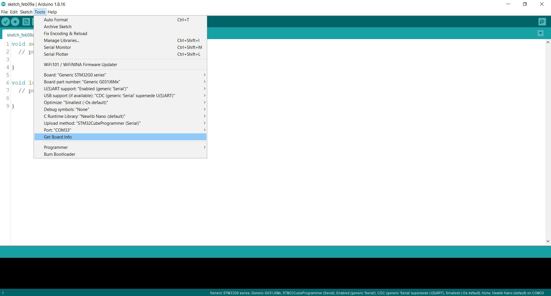

Hello, Thank you for the information and help. In the arduino IDE I have this Selected. I attached an image below. Can you please let me know if this is correct? I just want to make sure this is all correct. I have never used a stm micro processor before and I don't want to mess it up.
Joseph
Re: STM32G030J6M6 pinout.
Set USB to none. As this one has no USB support.

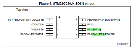

So change the usb support to none? From what I'm seeing it looks like from the variant.h the uart pins are PA2 for TX and PA15 for RX is that correct? these are the pins I can use to upload code?
Joseph
josephchrzempiec wrote: Wed Feb 09, 2022 5:43 pm So change the usb support to none? From what I'm seeing it looks like from the variant.h the uart pins are PA2 for TX and PA15 for RX is that correct? these are the pins I can use to upload code?
Joseph
MCU datasheet is your friend:
https://www.st.com/resource/en/datashee ... g030j6.pdf
page 14

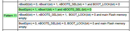

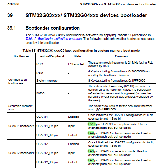

Referring to the AN2606:
So with this G030J6M, you can only use PA9/PA10 (in the peripheral pins it is PA_9_R and PA_10_R because they are remap respectively to PA11and PA12) as shown here:
Finally to enter in bootloader you have to follow one of this pattern. I don't know how the Option bytes are configured by default but I guess/hope it is the one using the Boot0 (PA14) pin value:
