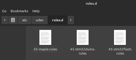

I did what you suggest. Created rules in udev, but still the problem occur.
maple:
ATTRS{idProduct}=="6001", ATTRS{idVendor}=="0403", MODE="664", GROUP="plugdev" SYMLINK+="maple", ENV{ID_MM_DEVICE_IGNORE}="1"
stm32duino:
ATTRS{idProduct}=="6001", ATTRS{idVendor}=="0403", MODE="664", GROUP="plugdev" SYMLINK+="stm32duino", ENV{ID_MM_DEVICE_IGNORE}="1"
stm32flash:
ATTRS{idProduct}=="6001", ATTRS{idVendor}=="0403", MODE="664", GROUP="plugdev" SYMLINK+="stm32flash", ENV{ID_MM_DEVICE_IGNORE}="1"

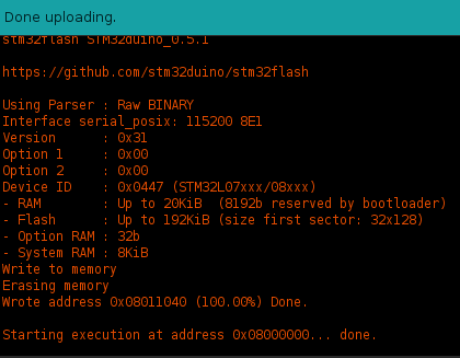

fpiSTM wrote: Tue May 17, 2022 12:20 pm No idea. Without more details hard to help.
Here's a sample of successful uploading via FTDI USB serial programmer on Linux OS:
When I check the serial monitor, the program freeze:
But when I try to upload it via Arduino IDE using windows OS, the program runs smoothly.
