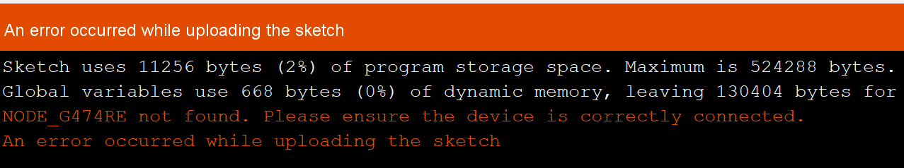

I have installed STcores in my Arduino IDE, and it also shown the 2 files on the board.
I selected the right "NUCLEO 64" and "G474RE" board.
While, when I updated sketch onto it, it doesn't shown on "Port".

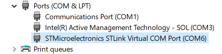

mianqi
Posts: 5
Joined: Wed Feb 12, 2020 4:35 am
Re: Couldn't find G474RE on "PORT"
Post by mianqi »
see the attachment.
@mianqi
This is the COM port but I ask you what is the name of the mass storage device mounted.
Your issue is that you use the upload method "Mass Storage".
Then it search the mass storage device named: "NODE_G474RE" which should appears when you plug the board.
If you don't have a mass storage mounted then I guess you have updated the STlink firmware without this support in this case yo can't go back.
