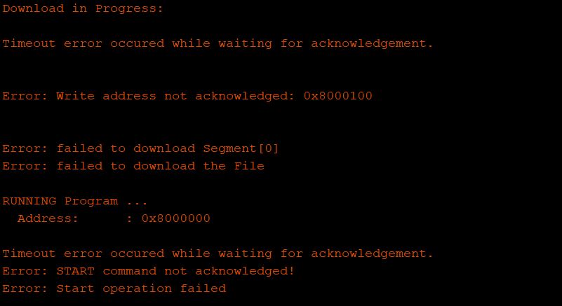

The result as I uploaded the code:

Your main issue is that the board is not properly flashed as stated in the log: 'Error: failed to download the file"
You have to ensure you start properly in bootloader mode.
As said I could not test as I do not have this hardware. Anyway, it should work.
Refer to the
https://www.st.com/resource/en/applicat ... ronics.pdf
to properly enter in this mode.

@urqwerty did you set boot0 and press reset ?

Already set the boot zero and able to upload the code properly. But seems the code still not working.
Still not able to integrate the device to the The Things Industries Cloud.
