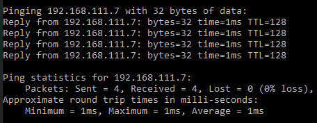

To sum up, to run ethernet on Netduino Plus 2 it is necessary:
1. set the clock
extern "C" void SystemClock_Config(void)
	RCC_OscInitTypeDef RCC_OscInitStruct = {};
	RCC_ClkInitTypeDef RCC_ClkInitStruct = {};
	/**Configure the main internal regulator output voltage
	__HAL_RCC_PWR_CLK_ENABLE();
	__HAL_PWR_VOLTAGESCALING_CONFIG(PWR_REGULATOR_VOLTAGE_SCALE1);
	/**Initializes the CPU, AHB and APB busses clocks
	RCC_OscInitStruct.OscillatorType = RCC_OSCILLATORTYPE_HSE;
	RCC_OscInitStruct.HSEState = RCC_HSE_ON;
	RCC_OscInitStruct.PLL.PLLState = RCC_PLL_ON;
	RCC_OscInitStruct.PLL.PLLSource = RCC_PLLSOURCE_HSE;
	RCC_OscInitStruct.PLL.PLLM = 25;
	RCC_OscInitStruct.PLL.PLLN = 336;
	RCC_OscInitStruct.PLL.PLLP = RCC_PLLP_DIV2;
	RCC_OscInitStruct.PLL.PLLQ = 7;
	if (HAL_RCC_OscConfig(&RCC_OscInitStruct) != HAL_OK) {
		Error_Handler();
	RCC_ClkInitStruct.ClockType = RCC_CLOCKTYPE_HCLK | RCC_CLOCKTYPE_SYSCLK
		| RCC_CLOCKTYPE_PCLK1 | RCC_CLOCKTYPE_PCLK2;
	RCC_ClkInitStruct.SYSCLKSource = RCC_SYSCLKSOURCE_PLLCLK;
	RCC_ClkInitStruct.AHBCLKDivider = RCC_SYSCLK_DIV1;
	RCC_ClkInitStruct.APB1CLKDivider = RCC_HCLK_DIV4;
	RCC_ClkInitStruct.APB2CLKDivider = RCC_HCLK_DIV2;
	if (HAL_RCC_ClockConfig(&RCC_ClkInitStruct, FLASH_LATENCY_5) != HAL_OK) {
		Error_Handler();
	/* Ensure CCM RAM clock is enabled */
	__HAL_RCC_CCMDATARAMEN_CLK_ENABLE();
2. set PA8 as clock for enc28J60
3. set the pins for SPI
	//clock setup
	//SystemClock_Config(); (extern)
	//PA8 as clock for enc28J60
	HAL_RCC_MCOConfig(RCC_MCO1, RCC_MCO1SOURCE_HSE, RCC_MCODIV_1);
	//PB4 as MISO
	SPI.setMISO(PB4);
	//PC8 as chip sellect
	Ethernet.init(PC8);
	//start ethernet
	Ethernet.begin(mac, Eth_ModuleIP);
