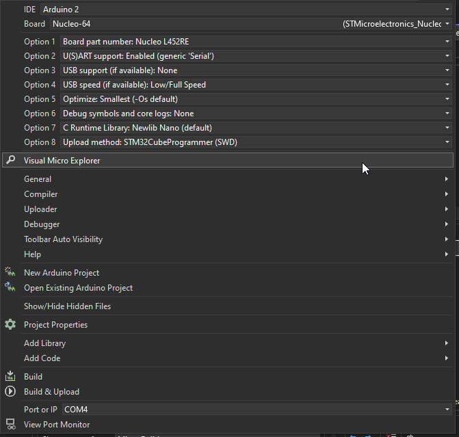

Here are the settings for the USB and more.
