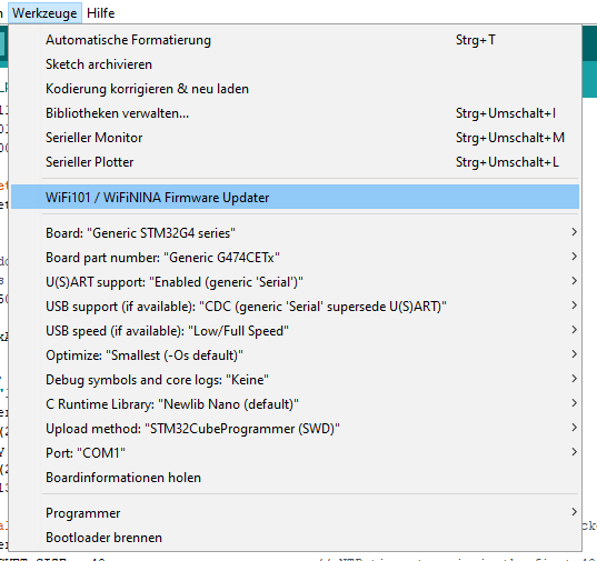

I am using Arduino 1.8.18 and a generic STM32G474CET. As i know there is no (ST-) commercial board. The core version is
Using board 'GenG4' from platform in folder: C:\...Arduino15\packages\STMicroelectronics\hardware\stm32\2.3.0
Using core 'arduino' from platform in folder: C:\...Arduino15\packages\STMicroelectronics\hardware\stm32\2.3.0

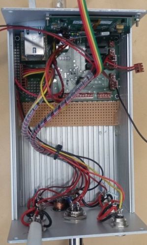

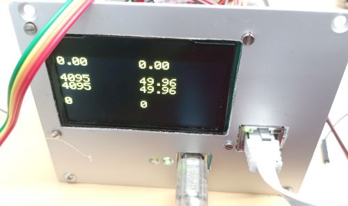

so all updated, same result, but it seems, that other used modules are influence the configuration.
I have tried it with the full code which includes webserver over w5500 spi modul, Oled over I2C and some other pins. That works with the old CPU but not with G474. using only the counter it works with the cpu. Analog sometimes yes, sometimes no.
I have to stop it for a day or until monday, because i gegan to make some mistakes by conecting/disconnecting the voltage and the pulses from the frequency generator and swapping between the different testcodes. I made it too often last 2 days.
On Monday i will check all again from scatch to avoid any made mistake.
Here 2 fotos to schow on what i am working.
