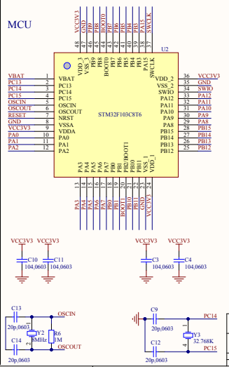

Hey guys, I'm a newbie at designing boards and wanted to create my own stm32 board to be used with stm32duino core with arduino.
I started with copying bluepill schematic and created a custom board and it works ok.
The F103C8 is just too much for what I need and looking at F030C8 is looking better for me and there's a generic support in stm32duino for it.
In my initial bluepill copy design I followed the crystal preference for the bluepill, which is 32.768 and 8mhz just like in the attached picture and like I mentioned it worked fine.
My question is would it be all right if i use the same crystals for F030C8? I checked the CubeIDE, created a project and under clock configuration it gives me the identical crystal preferences but I just wanted to ask you guys if there's a catch to all this crystal selection? Thank you

unless you have some interesting requirements (precise uart baud rate for example, or operating at the absolutely highest speed), the choices of xtal aren't that critical. I often run mine (f030f) with HSI, or 8Mhz / 10Mhz crystal, depending on what I have handy.
8Mhz crystal allows you to run at the max 48Mhz (8*6). 10Mhz can run at 45Mhz (10/2*9), or 50Mhz (10*5, slightly over spec).

Its a very basic board really, only runs some ws2812 leds thats all. Ok I see, so I should be good with the xtals i have. Thank you very much for the explanation it helped me alot as i had no idea how to go on about it :)
