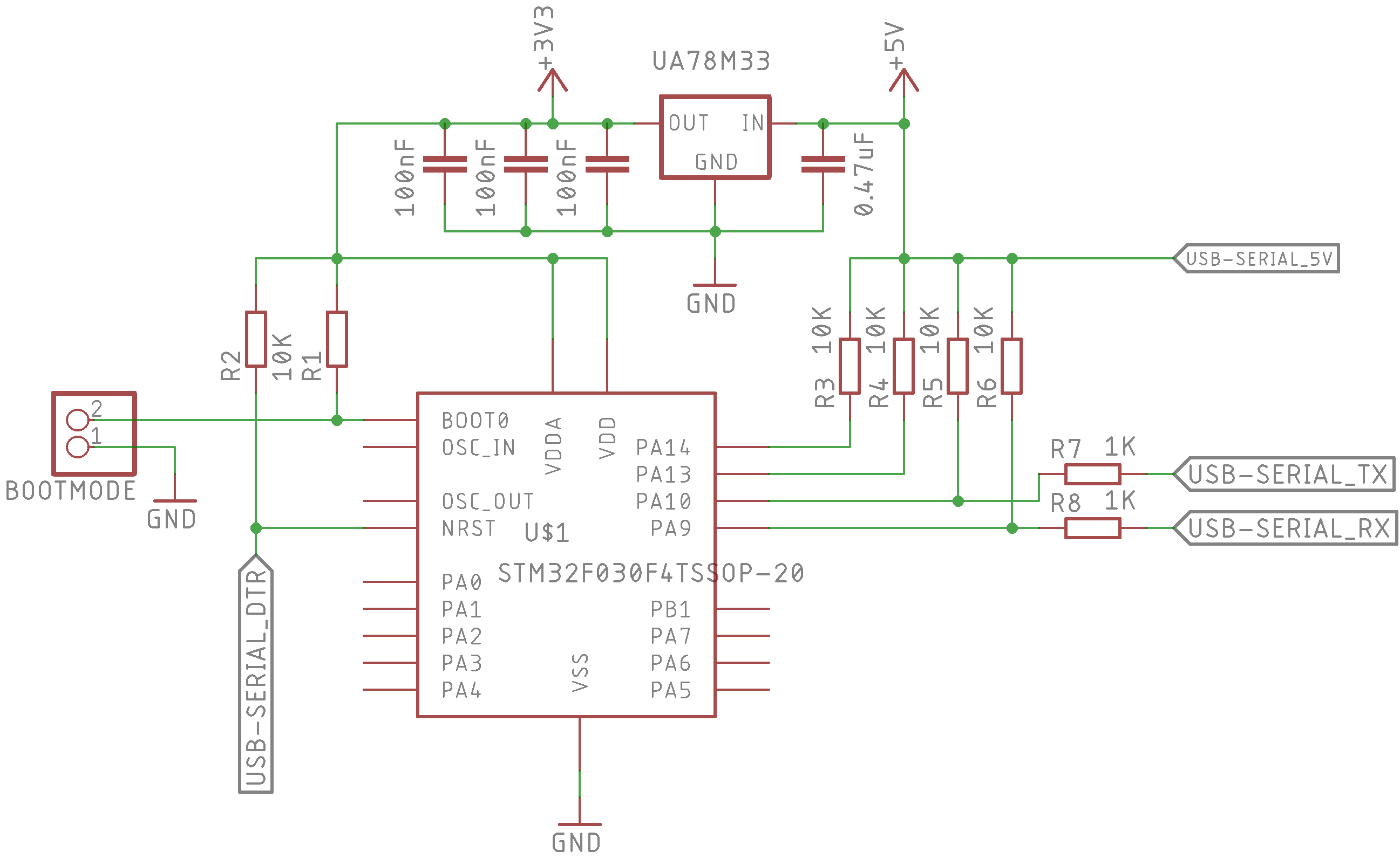

For my setup I have an STM32F030F4 soldered onto a breakout board. This is in turn soldered onto a piece of breadboard which also has a USB-Serial adapter soldered onto it, as well as a 3.3V voltage regulator to power the STM32. The regulator is an uA78M33 and the USB-Serial adapter is this one. This USB-Serial adapter provides 5V to the regulator and has a 100nF capacitor on the line labelled 'RST' so that it can restart the micro at the start of code upload. the BOOT0 pin has a pullup to 3.3V and is broken out a 2pin header so that I can short it to ground when I want.
Here is the schematic:
There are pullups to 5V on PA9, PA10, PA13 and PA14 because I'd like to use them to interface with a 5V DAC once I've gotten the micro working.
I don't have any resonators/crystals on hand so I'd like to use the internal RC as the system clock.
I believe that this setup is working since the upload process appears to complete without a hitch. Here is the console output once the upload is complete:

gives no output on pin PA4 and I'm not sure why. Is there an issue with trying to use the micro while it doesn't have an external clock source? I have some resonators on the way.
VDD and VDDA are both at a steady 3.3V and are each individually decoupled.
My understanding was the STM32s will look for an external clock source, and if there isn't one they'll default to using the internal RC.
If anyone could offer some advice I'd appreciate.
by Just4Fun » Thu Feb 27, 2020 1:23 pm
If I remember well, driving BOOT0 to 3.3V will start the internal serial bootloader for ever.
In this way, after every reset you will start the internal bootloader, not your "user" program...
So may be better:
1) disconnect NRST from the serial-usb DTR
2) reset the stm32 (BOOT0 = 3.3V -> Serial bootloader activated)
3) upload the "user" program with arduino (serial bootloader)
4) jumper BOOT0 to GND ( -> execute "user" program from flash)
5) reset.
Now your blink test should work...

yes, boot0 have to be pulled down for normal operation

You were on the money. After the upload has finished I can ground the BOOT0 pin and reset the MCU to make it work.
This behaviour is different to what I've seen on an STM32F103C8 that I've used on another project- with that one it automatically starts the user code after upload is finished.
