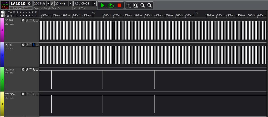

Hey :) thanks for your answer! with the updatet wire.h library it works most of the time.
Sometimes i do have a breakdown on the second i2c Bus. (attached picture)
Could be the reason, that I reuse the same variable to store the Sensor Variable and then send them away?
Is it possible to reset the Bus? I think i wrote somewhere that it is not possible...

Re: Bluepill as I2C Master and Slave
Hi
Fine. anyway they are several other fixes around I2C.
So, the best way is you use the master of the core or wait the next 1.9.0 release.
Ex:
https://github.com/stm32duino/Arduino_C ... 2/pull/888
