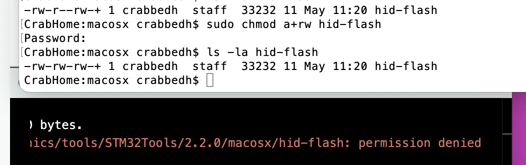

Following one online guide I was using HID-FLASH to upload and get permission denied, even though that file/script has RW permission for all..

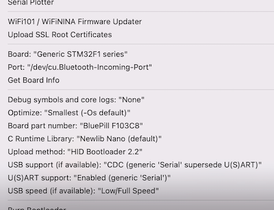

Other is I get no 'port' listed.. only the bluetooth one..
I don't have serial adapter and am hoping just to connect STM32F1 C8 blue pill to the mac and program.. have the lastest Arduino IDE and the lastest list of boards..

Set executable permission. chmod a+x.

F103 does not have hardware usb upload method. You need to flash usb bootloader first (using ST-Link or serial adapter).
Also it won't show bluepill's COM port until there's a sketch with USB CDC enabled flashed to it.
