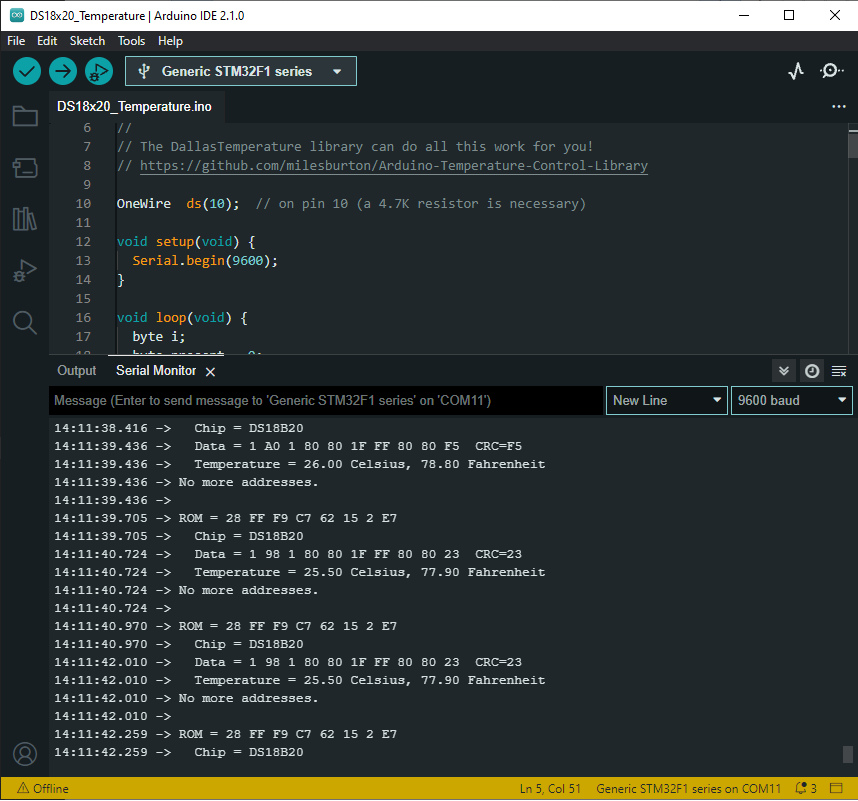

Re: Can't Work with DS18B20 with STM blue Pill
I've tested and it works, using GenericF103C6 and default sketch:
DSB connected with 5V, GND and data on pin 10 (PA10 for this generic). And of course a 4.7 resistor.
