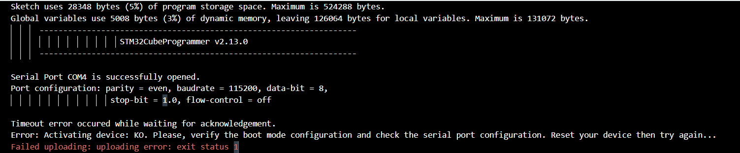

This is the error that shows
Screenshot 2023-07-21 173024.png (42.74 KiB) Viewed 2538 times
Re: BTT Octopus 1.1 for robotic project
if you do not have an st-link try
STMCubeProgammer32 (DFU)
^ that DFU programmer
To use this, you need to set the boot0 pin and press reset on the board
https://github.com/bigtreetech/BIGTREET ... %20PIN.pdf
^ if this matches your board, check the board document and find where is that BOOT0 jumper, somewhere in the middle of the board near the microcontroller. you need to patch that BOOT0 jumper then press reset before you do the upload.
When you want to use your sketch, then take up the BOOT0 jumper.
in addition, instead of using the Generic variant / board you may want to try
FYSETC_S6 under STM32F446VE
to build your sketch, it has less features memory and pin compared to ZG a bigger chip, but there is a chance the HSE crystal may be a same frequency.
that would let you try more features on the board.
If FYSETC_S6 works for your board, and then eventually, if you want to fully use your board, you need to copy the variant files for FYSETC_S6 into your own variant files with the appropriate names and make a new variant using that as an example.
