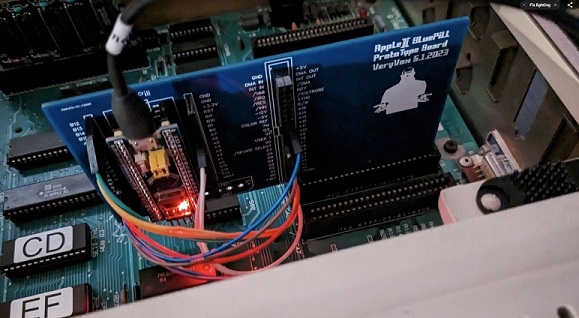

I designed an AppleII peripheral card with breakouts for the expansion slot and BluePill as an experimental project to interface the two:

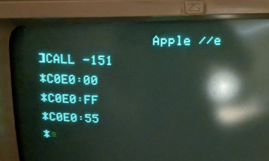

Ran these machine language commands on the Apple2 to write data to slot 6:

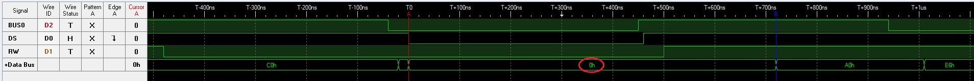

Just to be sure the machine language code was correct I connected a logic analyzer to the bus for each command and confirmed the data bus is correct:
(Edit: the images are hard to read, I put a red circle around the data bus values which match up with the commands)
C0E0-00
Apple Bus C0E0-00.jpg (84.82 KiB) Viewed 3837 times

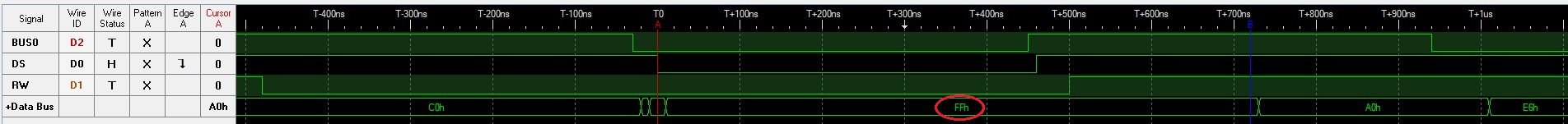

C0E0-FF
Apple Bus C0E0-FF.jpg (83.06 KiB) Viewed 3837 times

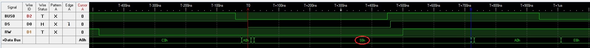

C0E0-55
Apple Bus C0E0-55.jpg (83.26 KiB) Viewed 3837 times
