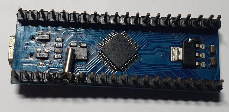

for a 1st time, I witness a non-oscillating 32k crystal for myself.
I'm using a maple mini (clone) :)
https://stm32-base.org/boards/STM32F103 ... Clone.html
The thing is this board don't have a 32k crystal patched. So I get one of those 32k crystals in a can
https://www.aliexpress.com/w/wholesale-32768.html
those are delightful, low costs, tiny :)
In the past, most of the maple mini works if I simply connect that 'crystal can' across PC14, PC15, no load capacitor etc.
I figured that at 32Khz, 10pf 'load capacitors' is practically 'open circuit', so I just omitted them :)
and it is from this same 'batch' i.e. I ordered a bunch of them, previously, they 'just work', patch it and it works.
here is how to patch a 32khz crystal, it works quite well if it works actually :lol:
maple mini (clone) with 32k crystal
But this time round, it doesn't oscillate. Apparently, the issue is quite common.
https://www.google.com/search?q=stm32+3 ... scillating
But for now rather than to figure out how to fix this, I dusted off a blue pill that has a working 32k crystal and used that instead

tried that, didn't work, partly as the crystal is a little isolated on its own as in the photo. The cap is a good idea to try, just that I'd need to dig to the bottom of the pile to find it :lol:
but that 10pf is pretty small, I'm thinking if I'd just use a little aluminium foil and sandwich a thin piece of paper between to make that, just that aluminium foil is hard to solder on
Re: 32k crystal won't oscillate
a quick and dirty way is to put one insulated wire and wound it up on another insulated wire. or just twisting two insulated wires together.
