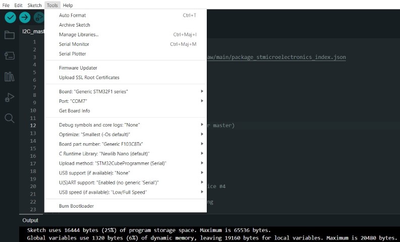

I am now sure the ide use my STM32 package (I had an incorrect line on the Wire.h from the ...\AppData\Local\arduino15\packages\STMicroelectronics\hardware\stm32\2.6.0\libraries\Wire\src\ directory, and I have an error in the IDE console when compiling!
Here my board configuration:
IDE_CONFIG (Petit).jpg (58.76 KiB) Viewed 5514 times
Really don't understand where is the trap..
