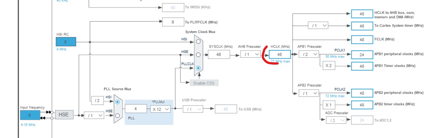

Next .. What is the STM32Duino system clock setting ?? well I have a stm32F103C8 and you could found the setting here :
"C:\...\AppData\Local\arduino15\packages\STMicroelectronics\hardware\stm32\2.6.0\variants\STM32F1xx\F103C8T_F103CB(T-U)\generic_clock.c"
and if you configure STMCubeMx with these values, you found :
setting clock stm32.jpg (79.65 KiB) Viewed 9360 times
So only 48MHz ! why not the "stock max" 72 MHz ??
I generate the clock setting code to get full clock frequency 72MHz (my board have a 8MHz crystal) :
