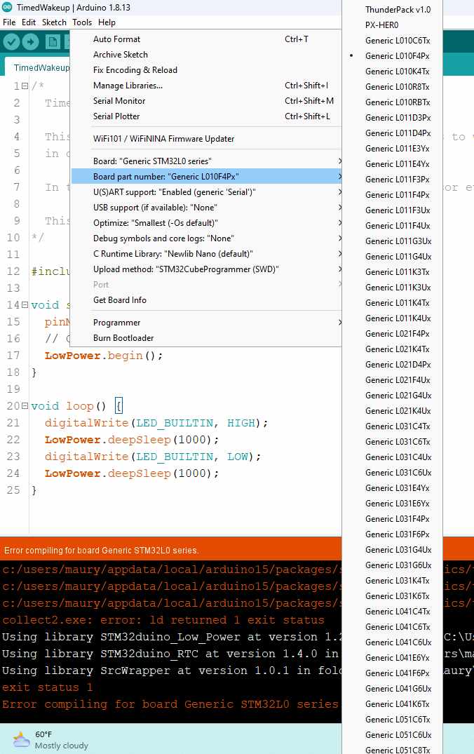

I selected STM32L010F4PX MCU for low cost and battery powered in my projected.
I facing issue, code not getting compile, I fallow this--> https://github.com/stm32duino/Arduino_C ... me-ov-file
#include "STM32LowPower.h"
  pinMode(LED_BUILTIN, OUTPUT);
  // Configure low power
  LowPower.begin();
  digitalWrite(LED_BUILTIN, HIGH);
  LowPower.deepSleep(1000);
  digitalWrite(LED_BUILTIN, LOW);
Error compiling for board Generic STM32L0 series.

Hi, the log is enough clear that the code can't fit to the Flash nor the RAM.
Unfortunately, depending of the mcu you used, the one with small flash and/or RAM require to do some customization.
Ex:
https://github.com/stm32duino/Arduino_C ... tes-of-ram
