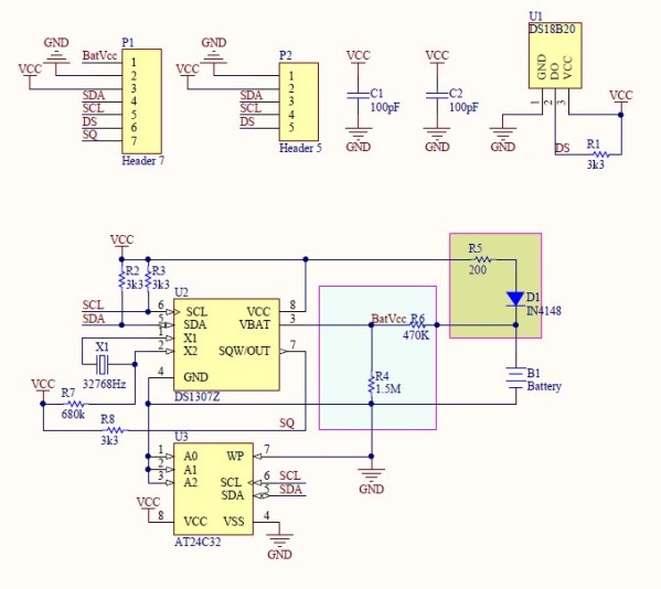

Yes - that's the embarrassing reason. :oops:
Using Arduino modules makes forgetting basing things.
Here it can be seen as R2 + R3 in an RTC module.
