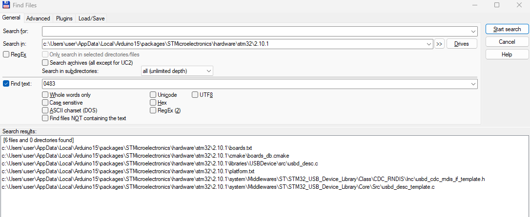

You can change those but drivers will stop loading, as they use VID and PID values to recognize device.
There a few files where those are set. The easiest way it to search all core files for VID or PID value (eg. using Unreal Commander or Total Commander).
Zrzut ekranu 2025-09-18 002706.png (47.93 KiB) Viewed 4 times
