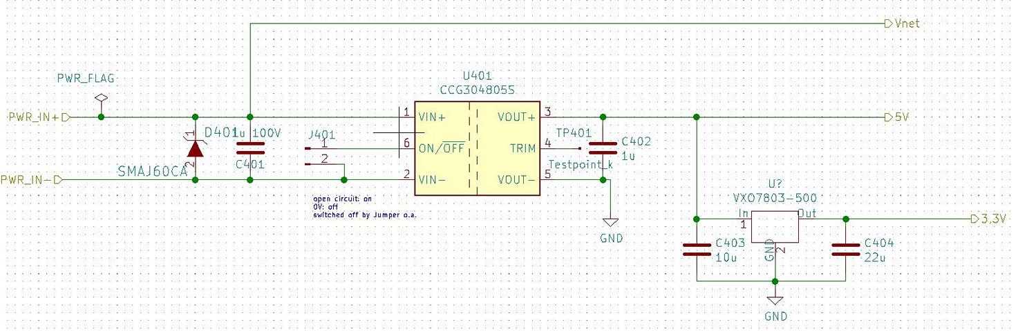

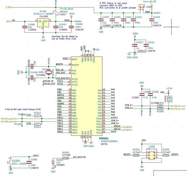

This are the Sheets:

One would not think the input supply is an issue unless your 5V regulator is having an issue, but you may wish to look at the 5V and 3.3V outputs and verify with a scope that your supply voltage is noise free. Additionally, if your HAT is on the rPi, you may be getting some RF hash into the traces which can play havoc with the uC. You can try putting a grounded shield between the rPi and the HAT ... I have used this stuff in the past with great success:
https://www.google.com/search?&q=mu+metal
but,
you can also cover aluminum foil with package tape (use a single stranded copper wire against the foil before taping) as a simple test. The foil should be grounded at the rPi ground plane.
Usually when exploring these complicated things, I try and simplify the testing ... forget the rPi, forget the 24V and use a 9V or 12V drycell battery holder for C/D cells. Now you are dealing with a simply homemade board, a stable power source, no RF hash from the rPi ....
Just a thought.

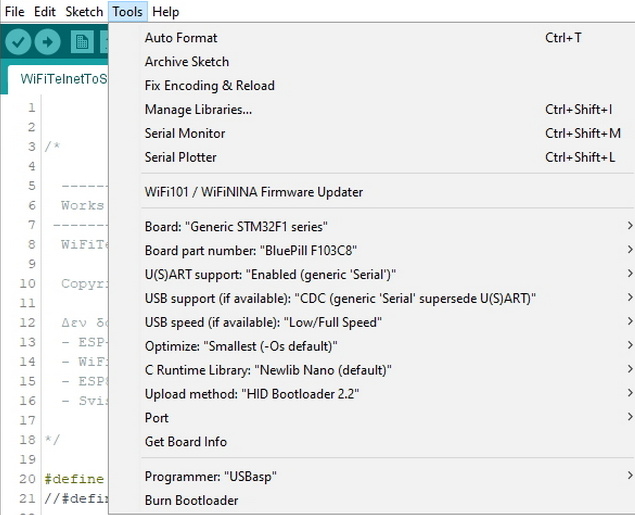

After you burn the HID bootloader with ST-Link, try to upload a blink sketch with HID Bootloader by using the following settings

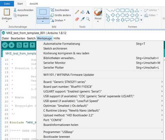

this are the Arduino Settings:
