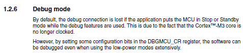

Re: STLink debugger doesn't come back from deepsleep
In debug mode some context are not the same.
This would require some extra configuration.
For example for he STM32F103:
http://www.st.com/st-web-ui/static/acti ... 171691.pdf

Cool, thanks. That gave me a pointer to search in the source of the arduino core. There is a function HAL_DBGMCU_EnableDBGStopMode (the official name of the LowPower.deepSleep mode is actually STOP mode in STM32 lingo) that I can use to set that register. But that still doesn't solve the issue. Even if I call it before LowPower.deepSleep, the device still hangs at the same place.
