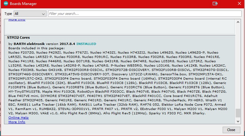

In trying to fix those errors, installed the STM32 cores, I already had the BARTH core installed in the IDE.
both cores appear to be named the same and conflict in IDE board manager, I can only see stm32cores in the board's manager but when selecting the board only the BARTH board is available.
Now it may be easier to fix the Neopixel compile errors, but I think the boards issue new fixing first.

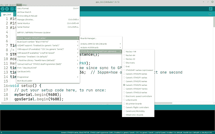

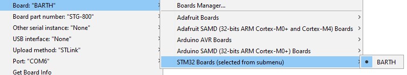

Honestly, I have never seen the IDE act that way. With Roger's core, one gets:
Have you "walked" the board selection menu, by groups? Sometimes I have to use 'Up-arrow' or 'Down-Arrow' to make the selection list scroll properly. The board groupings lists should not interact. But, to answer your specific question, address the issue to BARTH, if required.
fredbox
Posts: 125
Joined: Thu Dec 19, 2019 3:05 am
Re: BARTH STG with STM32F091xC
Post by fredbox »
The boards menu is improved with Arduino 1.8.13. Arduino and STM32 boards each have their own menu.

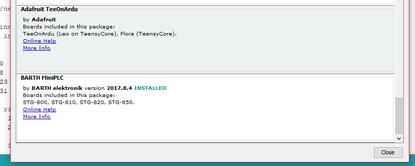

So it gets stranger...
when I first go into board manager.. I see the BARTH STG mini PLC controller listed.

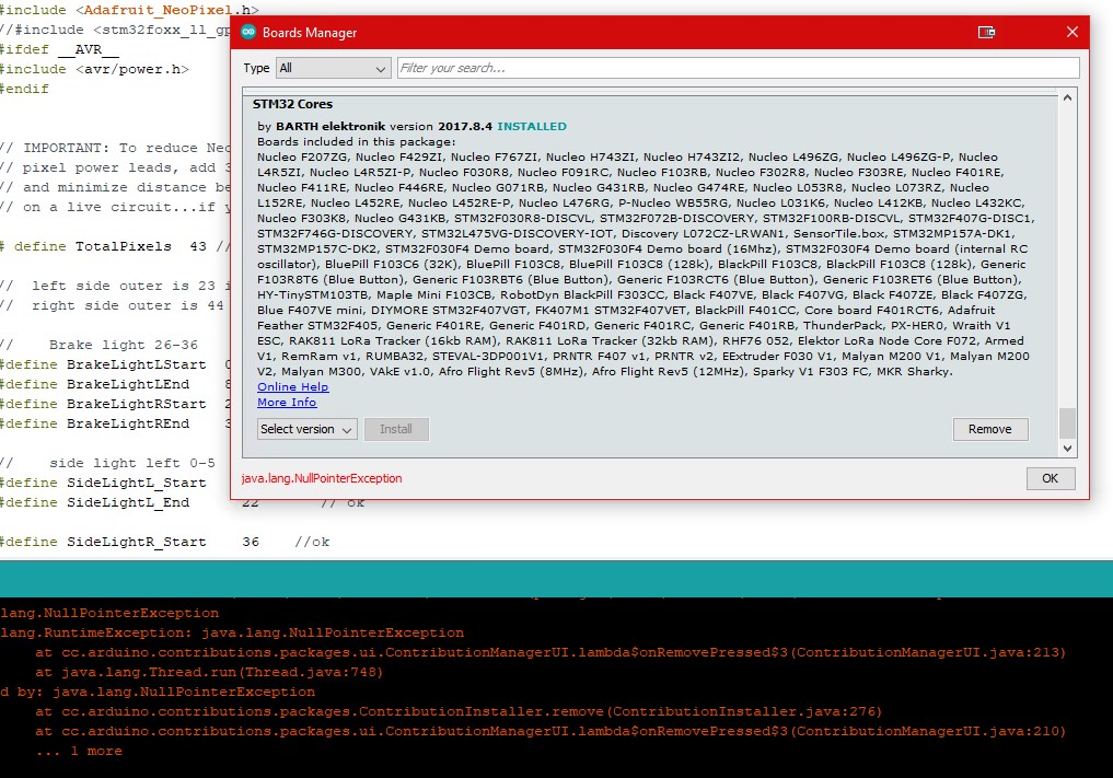

the moment I click the box the screen changes to this
I tried to remove the STM32 cores. but it will not go,
If I try to delete it again it complains it is not there , but clearly shows it when browsing the boards manager
I installed the STM32 cores on my main PC and they have the correct name in the library
This is a BARTH problem,
I will contact them and update here when I know more
thanks for the help..

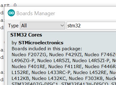

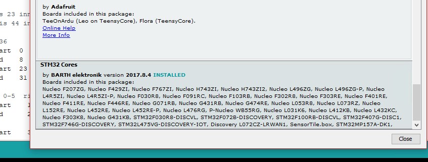

I'm wondering why you get this menu as it is not included in the STM32 core.
I found the answer, it was package in a standalone package which is very old.
https://github.com/jasysdotde/STG-8xx
This can explain why you got some trouble btw the STM32 core and this one.
I'm Frederic Pillon ;)
and honestly, I didn't aware of this or maybe I've forgot (more than 2 years).
Since that the STM32 core has changed a lot. the variant definition is not compatible with the latest core as several enhancements and features were added even the toolchains and tools have been updated a lot.
The best way to integrate it would be to use this method: https://github.com/stm32duino/wiki/wiki ... -on-a-core
Or simply add as a generic F0.
The way used is simply to zip the core and replace all default variants by the STG one.
