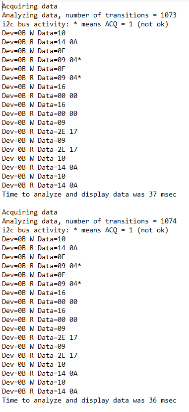

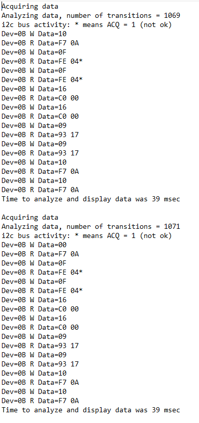

My setup: I am trying to communicate with an E-Bike display which acts as the I2C master. The display asks for data at defined addresses (like the index in a data array) in regular intervals and I need to answer these requests with the proper data. I was able to sniff what data gets sent between the display and battery using a I2C sniffer for the Arduino MEGA so I know what my answers should look like. I have written a program for the Arduino UNO to do this and it worked flawlessly.
Now I want to port this program to the STM32F103. The problem is that the STM is not responding to the requests properly. At first the sniffer showed me no activity on the bus apart from the repeated requests from the master, and after some research I found out about clock stretching and how it keeps the SCL line low as long as the STM is still busy. Unfortunately the Display didn't seem to care so I ended up with a constantly LOW SCL line and no responses from my STM.
After I disabled the clock stretching I got some responses but only the second of the two response bytes was correct, the first byte was always something different than it should be. I am now completely out of ideas and hope some of you might be able to help me.
