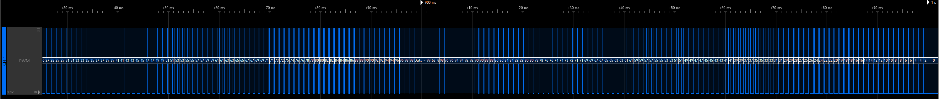

I've tested with a Nucleo F767 using pin PC9 (D29 on the REMRAM) with the same TIM3 CH4 and I see no issue without the +4, I've checked with a analyser.
Anyway your code never reach 100% due to the rounding of the computation ( /10) , the wrong max res value which should be (1<< res ) - 1
