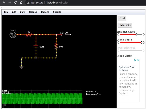

You can work the RC out manually or use an online circuit simulator to model.
In the circuit, the 100K resistance represents the DC impedance of the measuring device/meter and all leakage resistances.
$ 1 0.000005 24.46919322642204 97 5 50
R 112 112 64 112 0 2 1000 3.3 0 0 0.5
g 112 240 112 288 0
r 112 112 192 112 0 1000
c 192 112 192 240 0 1.0000000000000001e-7 -0.5543658984576727
w 112 240 192 240 0
w 192 112 304 112 0
r 304 112 304 240 0 100000
w 192 240 304 240 0
p 304 112 384 112 1 0 0
o 8 64 0 4098 5 0.1 0 1

Thank you @mrburnette for the detailed reply. Thanks for the warning too, I might have missed that and damaged the board.
I will try out the simulator first.
