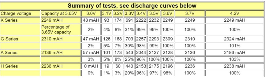

However, I have been using LiFePO4 for years and no overly complex charging regimen is required. They can be float-charged! This means one can use a DC-DC cheap boost (or buck) to get from solar cell to the 3.4'ish "perfect voltage" for battery charging.
https://www.powerstream.com/LLLF.htm
The 3.2 nominal terminal voltage is ideal for 3.3V microelectronics. At 3.4V, the cell is 96% - 99% charged and that voltage is safe for the STM32 uC which is rated <= 3.6V.
LiFePO4 charge percentages.jpg (82.35 KiB) Viewed 11375 times
https://www.powerstream.com/lithium-pho ... oltage.htm

Yep, that is what ag123 was saying by giving the PDF documentation for the algorithm + flowchart. No doubt, it is straight-forward and the dedicated IC's are cheap, but my point is if your power requirements match what a LiFePO4 cell will provide, then there is no need for an algorithm ... just set the POT on a DC-DC buck/boost (around $1) to 3.45 and you are good to go... I have used this technique for years and the cells are still taking a charge.

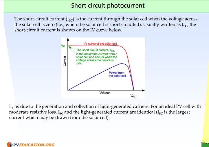

Among the considerations there's 2 pieces of non linear stuff here. The solar cells can deliver some combination of peak power, but shorting it literally gives zero power since voltage is zero. While the lithium Ion battery needs an elaborate constant current - constant voltage charging scheme. STM32 can perhaps manage the battery and charging for part of time, and does other things e.g. monitor sensors, drive actuators other part of time

ag123 wrote: Sat Oct 17, 2020 7:25 pm ...
I^2 R ... pssst, the doped silicon has a resistance :shock:
Screenshot 2020-10-17 195800.jpg (68.67 KiB) Viewed 11200 times

Yup, thanks Ray, saw a graph like such ;)
I'm thinking in terms of pulsing a P channel mosfet and charging the li-ion battery. STM32's adc can monitor voltages at the terminals. When the mosfet is off the input would be the open circuit voltage of the solar cells and the other end the residual voltage of the battery. Kind of a 'pwm'.
When the mosfet is on assuming a short circuit, the voltage would drop to the residual voltage of the battery. Below 4.2v, I can pretty much leave it to change. When it reaches 4.2v I can kind of 'pwm' it to mimic a reducing current charging say for an hour and finally off.
If it is dark, solar cells like diodes are naturally reverse biased hence back flow isn't an issue.
