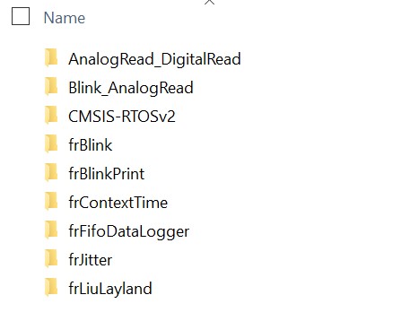

You provide little to no background info and I am not inclined to backtrack your posts to determine the board and uC model you are using. It is most helpful to repeat basic information with new post.
Mangy_Dog wrote: Mon Nov 09, 2020 7:13 pm ...What am i doing wrong? or is the library broken?
viewtopic.php?f=2&t=673
https://github.com/stm32duino/STM32Free ... ertos-v90x
The above link shows that not all boards passed all test examples.
Have you tried one or more basic examples?
