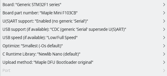

I use the Arduino IDE 1.8.10 on OpenSuse Leap 15.0 64 Bit and the Maple Mini,
and this package
https://github.com/stm32duino/BoardManagerFiles/raw/master/STM32/package_stm_index.json
I use this examble, it doesn't work (I have try "Serial.begin(57600)" and "SerialUSB.begin(57600)")

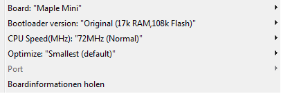

I have it also testet under Windows Arduino 1.8.10 with this package
https://github.com/rogerclarkmelbourne/Arduino_STM32
it works with it.
After a reset i become
ls -l /dev/serial/by-id
lrwxrwxrwx 1 root root 13 11. Jan 23:21 usb-LeafLabs_Maple-if00 -> ../../ttyACM0

@Ralf9
You're right it seems there is a regression with the BL usage.
I think there is an issue with the upload.
DFU has been modified in the Arduino Tools. I will check if this is the root cause.

@fredbox , @Ralf9
In fact, it works. I've the wrong bootloader. I thought I get the Original but no.
With the bootloder v2.0 it works fine.
maple_upload ttyACM0 2 1EAF:0003 /tmp/arduino_build_572333/AnalogReadSerial.ino.bin
