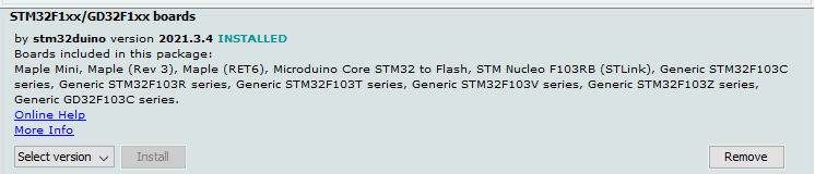

Aaargh... this board/library-naming thing is driving me nuts! Maybe someone can help unconfuse me?
In boards manager, there seem to be two sources of board defs for the STM32F103. This first one I've been calling "stm32duino" because that's who the boards manager says they're "by":

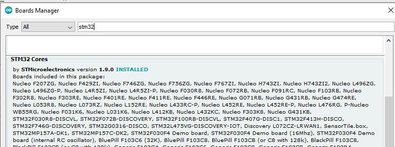

Earlier today (yes I'm new to using these boards!) I got the impression those were by Roger Clark but after looking around a little more just now I realized the Roger Clark stuff is something different.
This is the entry for what I thought were the "official" ST board definitions:

The "real" program uses an LCD that requires use of the "mcufriend_kbv" library, and that library does not work when I use the first board definition shown above (it throws compiler errors). So I'm stuck using the ST board def, but with that one the ADC is slow.
I've also done a ton of Googling on the slow-A/D issue and read lots of pages talking about various related things, including some of the oscilloscope projects. A lot of them seem to reference a function called "adc_set_sample_rate", but when I put that into my code the compiler says it's undefined, and I can't find it in any of the libraries I have installed. I've seen a few references here and there to a "Maple" library but don't see anything by that name in library manager. So I'm stuck on that one.
