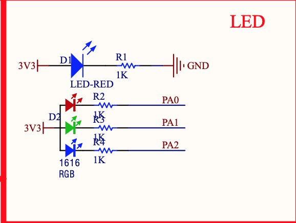

Hello everyone, I have a core board of F401CCU6. In the first test, I lighted three rgb leds.
The interval time is 1000ms,.
but after I upload the program, the interval between the two colors is about 2000ms.
This is much slower than in my code.

the code looks ok, among the things you may like to check if you are running at the expected system clock speeds for your board. that would have something to do with the crystal frequency
Re: F401CCU6 Clock too slow
Your code get each led OFF 2 second and ON 1s.
Is this expected ?

Test delay() speed by blinking a single LED.
Also, keep in mind that your LED is on when the pin is low.
Chances are that your code is doing exactly what you have told it to do and there is no issue with timing.

Hey,The crystal is 12mhz.
I also tried to set board = blackpill_f401cc, but the flashing time became faster, about 500ms apart

fpiSTM wrote: Mon Mar 15, 2021 5:32 pm Your code get each led OFF 2 second and ON 1s.
Is this expected ?
yeah,A total of three three-color leds.
When the pin is low, the LED will on.
Therefore, when one LED is turned on, the other two LEDs need to be kept off
