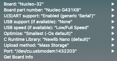

2. Configure the board/settings as on the screenshot below.
