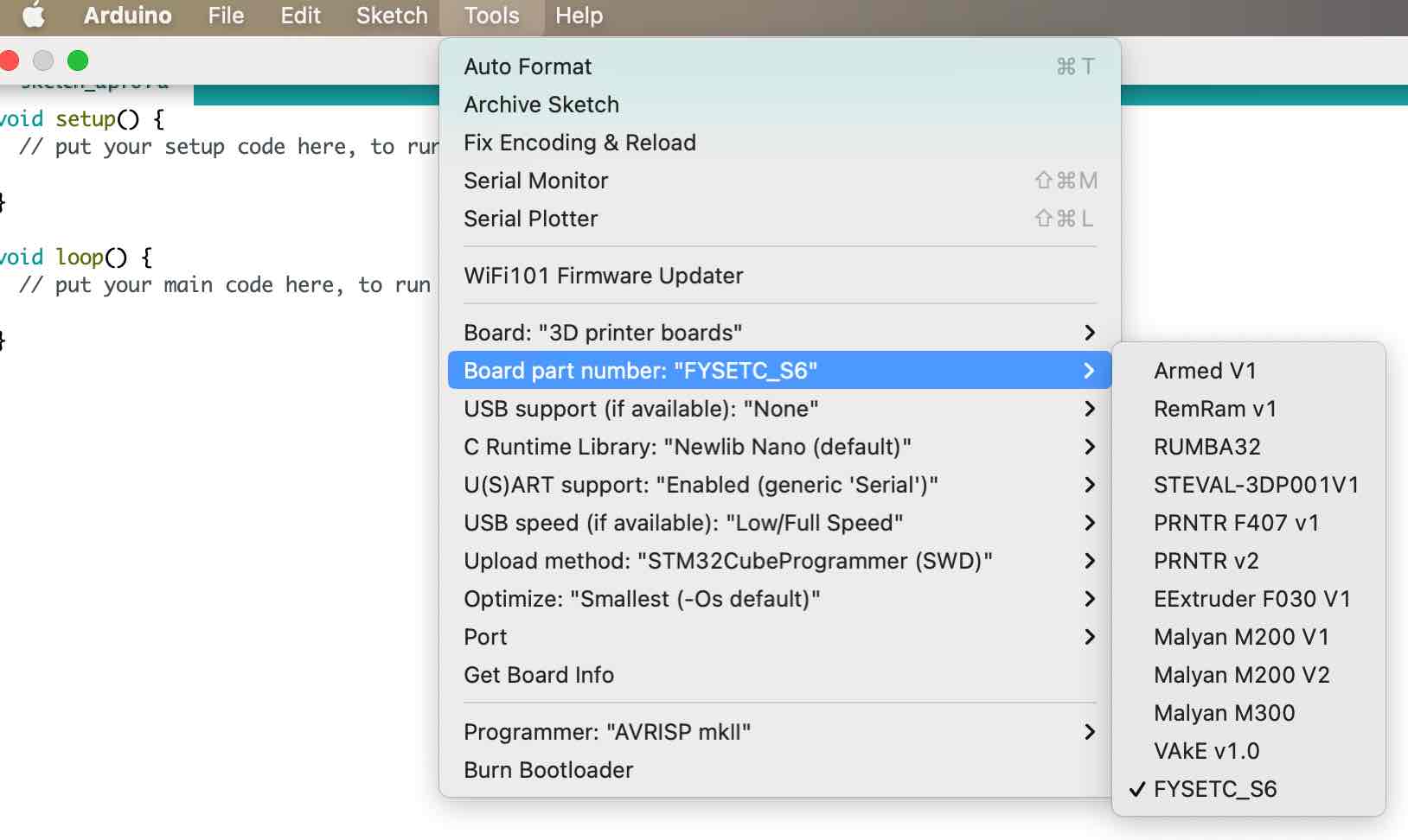

being a noob, I come looking for help with this board........
added the STM Cores boards package to arduino and am able to select the S6 board from the Tools section- so far so good......
but there are a number of other settings on the communication settings that elude me- what should these settings be?
sofar no successful connection (I use both Mac and Win environments)
I add a picture
everything below "Board part number: "Fysetc S6" is a mystery....
thx for your help
C
arduino on fysetc s6 board-STM32F446VE
- screen print.jpg (77.75 KiB) Viewed 8369 times
The board has no LED_BUILTIN defined which could simply means it does not have USER LED. That's all.
For Arduino it seems the easiest way is to use DFU. So select DFU in the upload method then follow those step to put your board in DFU mode.
https://wiki.fysetc.com/FYSETC_S6/#2enter-dfu-mode
Go to full postFor Arduino it seems the easiest way is to use DFU. So select DFU in the upload method then follow those step to put your board in DFU mode.

You should first have a look in the wiki which describe some options.
https://github.com/stm32duino/wiki/wiki/Getting-Started
Optimize is the best compromise so keep it, same for newlib. Other are enough precise, if you need USB enable it else keep it to none.
USART support enable by default one Serial, which is defined on PA10/PA9 (Rx/Tx).
by default upload is the SWD, which means STLink. You have to install the STM32CubeProgrammer as described in the wiki.
Keep the default options then it should works.

thx for your help, about the STM32Cubeprogrammer- which wiki do you refer to?
I have it installed, should it be in a special directory?
best
C

thx for your help, so far not much of a success
in the mean time installed Platformio as alternative
selected the Arduino environment, installed the S6 package, should work just fine, as shown in the youtube videos.......error loading...pffff
even the "bare minimum" example- no succes- compiling yes, uploading no..
Blink no succes- LED_BUILTIN apparently not specified???? - btw I don't know if the S6 board has a led for this
Power leds are on
I know that my noob-ness is not helping here, but is difficult to get a handle on
the F6 boards (AVR) run fine on Arduino IDE
best
C

SUCCESS!!!!!!!!!!!!!!!!
Merci beaucoup!!
