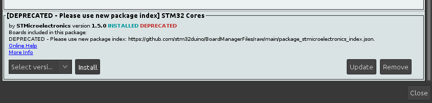

The problem still occurs on Putty and I also patch it directly to dev/ttyUSB0, still the same.
I'm using an old verion of STM32Core 1.5.0, it has the built-in stm32flash
I'm currently using ACSIP S76S LoRA chip containing an STMicro STM32L073RZ MCU
my Device ID is: (STM32L07xxx/08xxx)

Re: Linux serial_posix vs. Windows serial_w32
I don't think it is link to upload tools. You can simply try to flash the windows generated binary using the command line on Linux.
and vice versa.
My guess is the USB implementation done on Linux wit 1.5.0 has probably an issue.
Since core version 1.5.0 there is a lot of work, I would suggest to port your "firmware" on the latest version or a least 1.9.0.
and vice versa.
I follow your suggestion to use the official and updated Arduino STM32cores. I also make my own variant. I editted the boards.txt to have it on my board menu. I receive this error. I wonder how to fix it. Thanks in advance.
