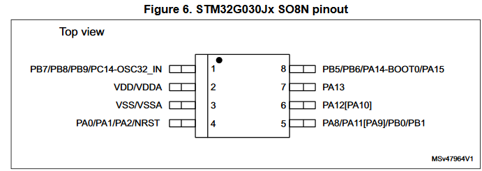

They are a lot of pins. Which one is which for the 8 pin processor that I do have? It shows pa and pb. Also shows pa_r pins I have no clue. All I’m trying to do is put a oled screen on the processor. But unsure which pin I need to put it on.
Is it the PA9_R and PA10_R?
Joseph
Re: STM32G030J6M6 pinout.
The variant describes all pins available for STM32G030J6M. But depending of the package not all are available.
You have to refers to the datasheet and use the one you need/want --> https://www.st.com/resource/en/datashee ... g030j6.pdf
Example for SO-8
The datasheet also list properly each pins for each packages, see : Table 12. Pin assignment and description
PYn_R pins define in the variant indicate that those pins required to perform a remap, in the picture case: PA12[PA10] means PA12 is accessible without remap while PA10 require to perform a remap (PA10_R). You could not use PA12 and PA10 at the same time.
