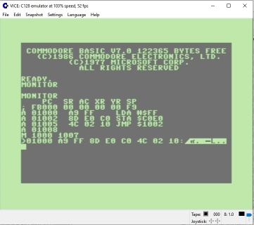

However! When I use code like this without interrupts:
    while (true) {
        while( ! ((value = GPIOB->IDR) & (1<<3)) ) {
            counter++;
        if (counter != previous_counter) {
          Serial.write("Counter = ");
          Serial.println(counter);
          displayBits32(value);
          counter = 0;  previous_counter = 0;
I'm getting valid data! Normally the "counter" value is 1, 2 or 3. I've never seen 4. This leads me to wonder where the overhead is coming from. If the sampling rate is anywhere near 72Mhz, and DS is low for at least 450ns, then how could we only sample the register 2 or 3 times???
Some sample output (0x00, 0x01, 0xFF)
Counter = 3
00000000 00000000 00000000 00111000
Counter = 3
00000000 00000000 00000001 00111000
Counter = 2
00000000 00000000 11111111 00111000
To get faster sampling, I think i'll have to drop the convenient Arduino IDE toolchain and look towards something more bare metal like platformio/toolchain-gccarmnoneeabi as I saw a project like BlueSCSI uses.

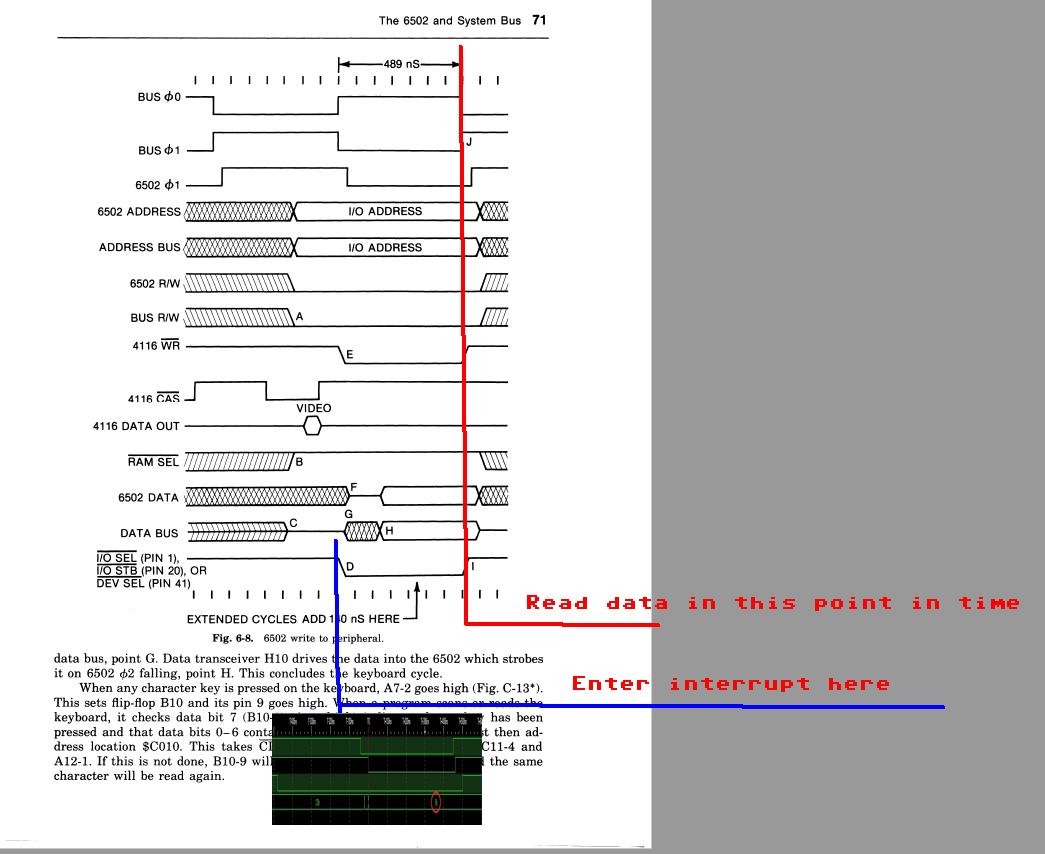

Bakisha wrote: Thu Jul 06, 2023 8:02 pm Anyway, by looking at datasheet you posted in first post, i still think you need to experiment and see what timings give you predictable result.
Yes totally agree with those timings. It's the bare metal timings on the bluepill that I need to learn now! Thank you for your suggestions.
p.s. about the lines in your drawing about "enter interrupt" and "read data" I tried that technique many times and adjusting things. Always the read was too late. It's like the interrupt latency is too high to capture within 450ns, and I couldn't figure out how to set interrupt priority in this framework.

Just an a idea for experiment:
Attach interrupt on RW falling, and if DS is low grab data? It would trigger on every write, but writes on 6502 is not so often. As long as ISR is shorter than 4µS, it should be working for latency up to 800, maybe 900nS.
Something like:

Re: Can’t read AppleII 8-bit Data Bus with Blue Pill
20 - 40 ticks for isr overhead - depending on lots of factors. at 72Mhz, that means 300-600ns. so I think you have a fighting chance, if you read the input data register rightaway in the isr.
one way to measure the isr is to read a counter (DWT for example), trigger an isr (by setting a flag) and within that isr, read the counter again. the delta between the two readings is your isr overhead / latency.
