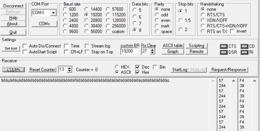

Hi, I'm trying to migrate from 1.9.0 to 2.4.0 arduino core and have an issue with usart.
Initialization:
#define TX_PIN                                PA15
#define RX_PIN                                PB3
HardwareSerial hws(RX_PIN, TX_PIN);
const char data[] = {0xAA, 0x00, 0xFF};
  hws.begin(19200, SERIAL_8N1);
Loop:
  hws.write(data, 3);
As a result I'm getting garbage:
All the possible actions like speed, mode, pinout and other already checked. In the variant all is correctly configured. Same code correctly works on 1.9.0 core.
It is strange, that received bytes count is not equals to bytes sent.
by fpiSTM » Wed Feb 22, 2023 4:24 pm
OK. That's fine if you declare it.
Pay attention for USB, it requires 48MHz input clock.
I saw that you used HSE. My guess is that the value of this HSE is not the default one defined by STM32 HAL:
https://github.com/stm32duino/Arduino_C ... h#L99-L101
which is 8MHz. So if your HSE has a different value you have to redefine it else the systemCoreClock frequency is not correct which could explain your issue with serial as it probably impact baudrate.

Yes, you are right - my crystal have 12MHz frequency and I missed this. :roll:
The fix is pretty simple - just by adding to the boards.txt for appropriate board/variant next config:
xxx.build.extra_flags=-DHSE_VALUE=12000000
Thank you for your help :)
