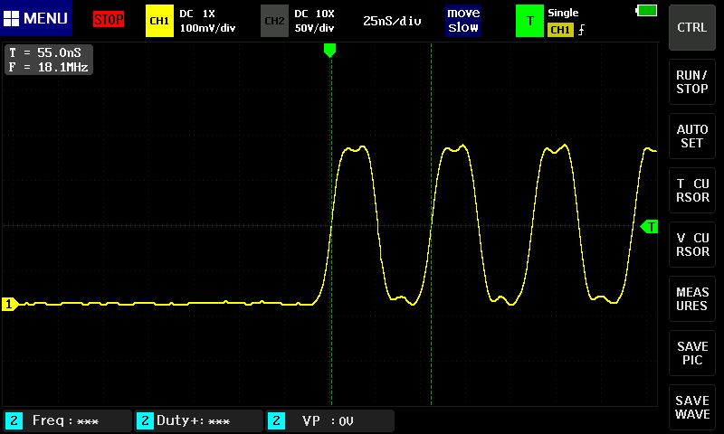

Re: Speed Up your IO !!
GonzoG wrote: Mon Oct 23, 2023 7:27 pm I got 19MHz wit digitalReadFast and 33MHz with digitalWriteFast, but with typing 1000 lines of code.
While loop needs few cycles.
ManX84 wrote: Mon Oct 23, 2023 9:43 pm @GonzoG PLease give us your code ! (I do not pretend to get the fastest .. just starting to play)
Sorry.. copied wrong values. Those were Mops/s, so frequency is half of those. Measured with "toy" oscilloscope and digitalWriteFast gave me 18MHz signal.
code is really simple: 500x
digitalWriteFast(PA1,1);
digitalWriteFast(PA1,0);
18MHz signal.
Fast IO is implemented via BRR/BSRR.
Hard to imagine that they could get that fast.
dannyf wrote: Wed Oct 25, 2023 9:42 pm
18MHz signal.
digitalWriteFast and digitalReadFast are using LL functions. With O3 (fastest) optimization they can go this fast.
On F401 and F411 they need 1 MCU cycle.
This is what I get with F411CE:
